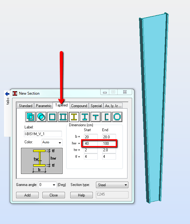

    Hi. I want creative frame Zamil of robot same picture . I is attachments

    Moderator
    Romanich
    Posts: 406
    Registered: ‎09-29-2009
    Re: Design colum Steel of Robot
    08-01-2012 11:24 PM in reply to: athurD
    Also, you can use shells for column:

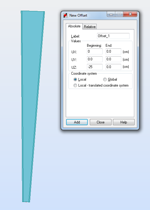

    Moderator
    Romanich
    Posts: 406
    08-02-2012 12:13 AM in reply to: athurD
    Sorry, but I didn't understand your idea.
    Also, if you want use tapered bar with one vertical flange, try to use Offset option. But note, as an Artur wrote - bar element is just the line that represents the center of the section with assigned attributes such as profile type.
