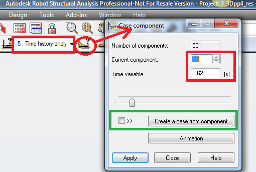

    Time history analysis (THA) give results (forces, displacements, moments,etc) in series of time steps.
    For instance in my examples it was defined with such paramaters that the results were output in 501 steps from t=0 sec to t=5 sec.
    The results of all these steps can be seen in the tables when tables are filtered only to THA case - see below:
    In the graphical window the results (deformed shapes, diagrammes of moments,...) can be also displayed for selected time (as if a single picture from the video) selecting THA load case and appropriate component of it:
    Direct application of the force of 15000kN as static load case would give completely different (bigger) results than THA because it would correspond to static application of this load without vibrations (constant displacements, forces, moments etc). In case of THA the load is acting very short (0.01 sec in my example) and is resulting in variable in time displacements, forces, moments etc.
    When using THA results in design it is the best to find time steps with the extreme forces or moments and to convert them to simple cases - see the green rectangle in the screen capture above. Such cases can be easily combined with other load cases and used in design.
