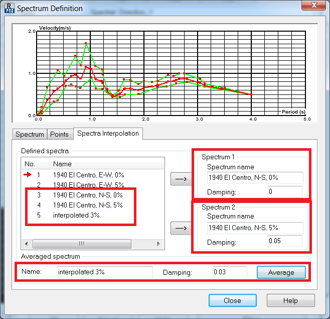

    Hi Pawel thanks for your reply.  What about this damping setting:

    This damping setting would be used only when using this spectra in Spectra Interpolation:
    If this post answers your question please click "Accept as Solution". It will help everyone to find answer more quickly!

    damping from properties of spectra is used in spectra averaging not only in spectra definion but also when using averaged spectra directly in spectral load case - see the screen capture below:
    In such case the actual relative damping used to calculate averaged spectra will be taken from advanced parameters of modal case preceding this spectral case.
