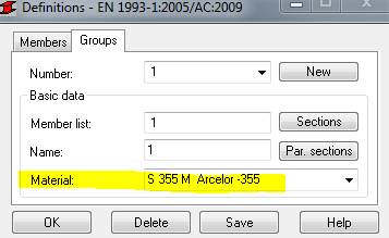

    Please make sure you have the correct material set in the group definition dialog.

    Thank you for the quick response. That helped.
    The code group was created through the API and apparently the material of the member is not set as default and you need to define it explicit.
