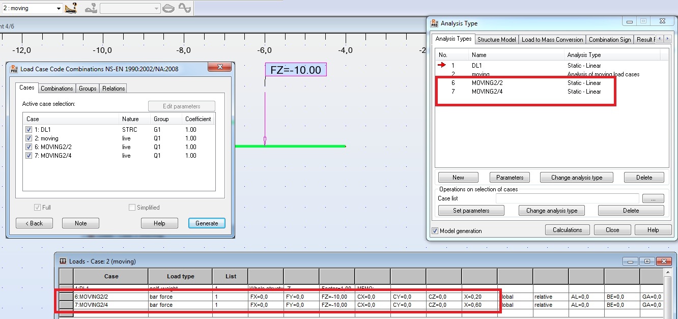

    Posts: 770
    Registered: 04-26-2010
    Re: CHARGES ROULANTES / MOVING LOADS
    02-22-2012 05:08 AM in reply to: acarimalo
    acarimalo
    1- The button "creer cas" create only a virtual case (for visual use only) :
    • the create case doesn't appear in the generator of combinations
    • if I run a new calculation the virtual create case disappear from everywhere
    I guess you mean something different because these cases are not witrual:
    Rafal Gaweda
