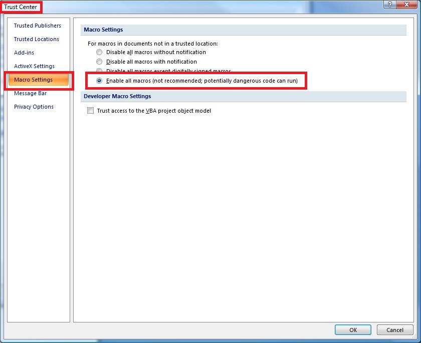

    Hi Rafal,
    all the macros are enabled (see attached), in addition of this, I installed openoffice and recieved another error message (see attached).
    Gustavo

    Product Support
    Posts: 2,507
    Registered: ‎04-26-2010
    Re: Autodesk certification expired
    11-23-2011 12:57 AM in reply to: gustavo.c.vasconcellos
    Try this
    open Command Prompt as ADMIN
    then
     unregister ALL ROBOTS you have installed on your computer by command: path_to_robot.exe / unregserver
    eg:
    "C:\Program Files\Autodesk\Autodesk Robot Structural Analysis Professional 2011\System\Exe\robot.EXE" /unRegServer
    (use such line as above in this Comand Prompt window)
    then
    register the one you want to use.
    eg:
    "C:\Program Files\Autodesk\Autodesk Robot Structural Analysis Professional 2012\System\Exe\robot.EXE" /RegServer
    then check
    Rafal Gaweda
    Product Support
    Autodesk, Inc.
    Please use plain text.
    Distinguished Contributor
    Posts: 104
    Registered: ‎04-15-2011
    11-23-2011 11:00 AM in reply to: RG_Adsk
    Great, it is working now!!!
    Gustavo
