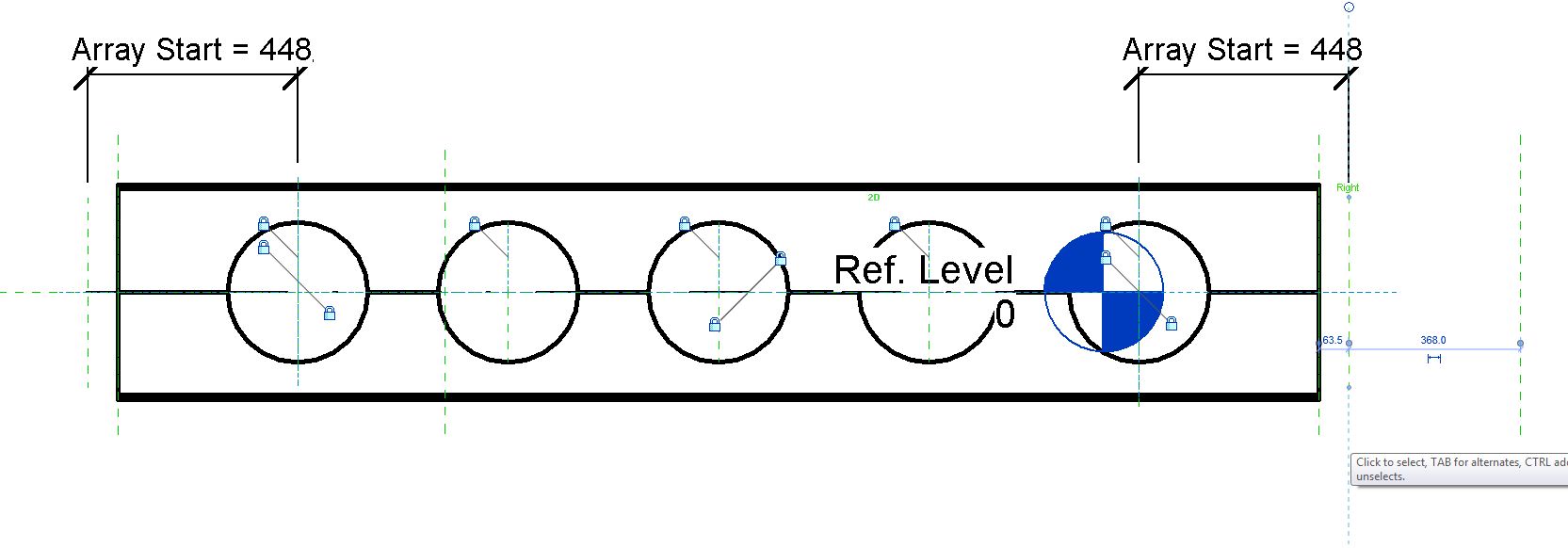

    i have some cell beams to create. Ive made one already for a test floor but i have a problem with the hold lining up. Attached images.
    Can someone point me in the direction of some guidance (if there is some) on the best way to change the parameters.
    i have one bema that spans from column to column. when i use it to span from column to core wall, the holes then dont align.
    Do i need a new beam?,  a new family?
    (p.s this is fairly new to me!)
    Two beams shown here
    Ive tried chaging the offset dims on the right but it effects both beams, so would i need a new family?, if this is the case, i guess i would need a few as there is bound to be other situations??

    Any one shed some light??. i ve had some help from another forum but still struggling to be honest. Is it possilble for revit to do this?
    with holes aligned throughout the floor, will i need a new beam for each one, so a WB01, but maybe 3 types if the holes vary so 3 families. With a 12 storey building this could mean a lot of families if i have a total of 150 odd beam types?!
    Is there any other ways of achieving this similar outcome?
    only every done this in micorstation but we used the hole layout from a 2d file we referenced in

    Hi. I'm not sure I fully understand your problem. If I understand correctly you have the same beam with different spans unless your distance to column and wall are exactly the same. In this case, the alignment will be different because you are setting the start and end arrays at a fixed distance. So, whenever you have different distances you will have different alignment. If I misunderstood, please clarify or send a file so that I can take a look at it.
