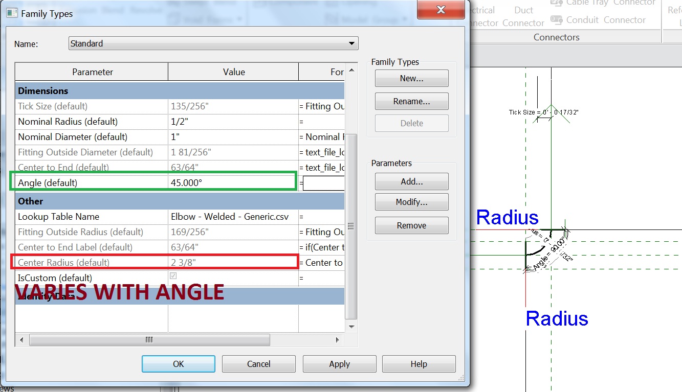

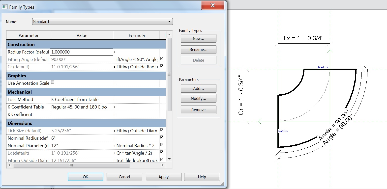

    Perhaps someone can explain to me on why the out of the box generic welded elbows aren't as customizable as they should be?  If the elbow is 90 degrees, it appears to be a short radius elbow.  However, if the elbow is acute (less than 90 degrees), the elbow has a longer turn radius.  It also appears to have a varying turn radius as the angle changes --- which I don't really understand.  I've had to copy/paste/modify the out of the box family to get elbows with a turn radius that can be controlled by user (instance parameter) and change a few other parameters.
    It's not something new, but I've never really understood this.

    The problem is in the out-of-the-box look-up tables.  I had suspected that other families had this problem as well.  I had to modify the look-up table and distribute that to my users.
    I am not sure it's the data in the look up tables that is incorrect --- or at least that's not the only thing.  The fitting outer diameter values in the look up table are close to REVIT's default values for a schedule 40 carbon steel pipe.  The formula for the turning radius varies with the angle.  This occurs with the default pvc elbow as well.
