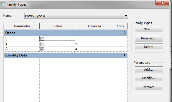

    Here's a simple demonstration of using 3 type yes/no parameters with 3 family types (in 1 family called ABC)...
    A, B, and C are model text overlapping each other.  Each has its visibility set by the value of their respective yes/no parameter (A, B, or C).  There are (3) family types ... each with (1) parameter on and (2) parameters off.  This acts like a radio button.  By default (without programming probably), REVIT does not allow for radio buttons to be created by the user (unless I completely missed something). This is one way to mimic a set of radio buttons where you want to choose only one letter.
    In your case, you have different enclosures and perhaps with completely different geometries per enclosure.  You can model each enclosure with your engine family or outside and have them/their visibility be controlled by a parameter made within engine family.  If the geometries of each enclosure only differed by changing a few angles, lengths, ... you can might be able to avoid the visibility/overlap and gone with constraining with a variety of parameters, planes, lines, etc ... just like you would with a lot of equipment with various sizes.
