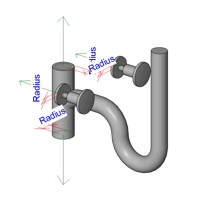

    Type mapping is a good way to go. We've also created a family of just a few extrusions with hot and cold water pipe connectors, and a sweep to serve as a P trap with sanitary and vent pipe connectors.That way the architect can just use whatever plumbing family they want and we just place ours on top.
     With this method, you won't have the copy/monitor functionality. The downside is that you'll have to manually move the fixtures, but the plus side is that if the architect decides to do something silly like flip a restroom (which never happens :smileyhappy:), Revit won't freak out and break all your plumbing connections, you can just group and mirror your fixtures.
