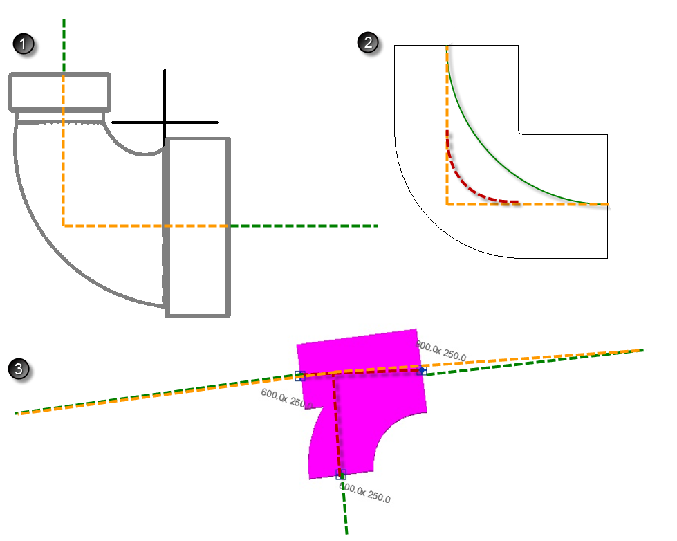

    basically what i am trying to do is to write an API to get the total duct length in a revit mep model, which included all those straight Duct and Duct fittings, and the main issue is on Duct fittings,
    while you are saying the Lengths parameter is to control "the dimensional constraints of the model element and the lines" that make so much  sense as well, since some of them are adjustable and some don't, i suppose with particular duct fitting families, for each of those parameters there is a uique fomula behind it, let say when the modeller change one of the parameter they will calculate the scale\lengths parameter of the object.

    Hello FabZico... as far as projection, I was just referring to using vector math to find the intersections of the connections... there are no special methods that I am aware of, but there may be some vector math libraries that are generally available that may help.
    The assumption that at an elbow the distances from the connector to the 'center point' will be equal isn't necessarily always true.  A reducing elbow (1) won't have this case.. similarly, some duct fittings may have a longer length on one 'leg' than on the other.   the approach is interesting... however, as you can see in (2) below, may actually come up shorter than the 'average' path... the green line is using the method you proposed.. the orange line is using the project-into method... and the red-line is probably what some may consider 'average'.  In the application I had worked on, the accuracy wasn't critical, and simplicity was a necessity... so the 'orange path' is what was used.
    (3) basically shows the same method applied to the tee. The red lines indicate the 'projection', the green lines indicate the 'true' duct path, and the orange line represents the 'projected' duct path.  You can see there is some 'error', but depending on the application, it may or may not be critical.  9-14-2012 12-15-43 PM.png

    Thanks Martin, you are correct, and reducing elbow is one of the issue that i missed out, thanks for pointing that out,so A is not always equal to B, A is equal to B only if the in and out length of the elbow is equal, for my method, an additon in-and-out length check will be required.
    For the case 2 issue that you point out, for my application, below average is not acceptable , therefore my method cannot use it in such case direct, but still i believe my method should help to get the red path length, what required is to get length,mid point of the blue line that i drew below, but for this moment i am not quite sure how to get those yet to be honest lol, but anyway, one we get that red length, then we add those yellow length should be able to get a quite accerate length of this elbow.
    for my application, since it is more like a measurement tool, therefore accuracy is important, I believe martin your projection method sugguestion should also be quite accurate as well, since the conner length different should still be very small compare to the total length and should be acceptable.
