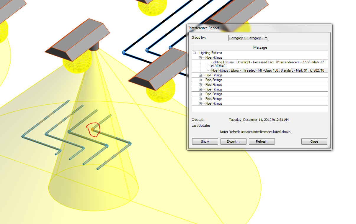

    Can anyone please tell me why Revit finds hundreds of clashes that are not actually present? Please see image attached. I find myself working through hundreds of clashes with electrical lights/cable trays and fire pipes/fitting/sprinklers. Is there a way to fix this? I spend way to many hours working through clashed that are not there.
    Please help!

    I found this out the hard way recently - the architect called us in a panic because we had hundreds of light fixture clashes. Apparently Revit considers the Light Source geometry to be part of the light fixture and includes it in clash detection! Neat! Turn on your light sources and I bet you'll see the clash. I have no idea how to resolve this however. Maybe Navisworks can exclude the light source geometry.

    Update: OK this is strange. I can't get the default plain recessed lighting fixture to cause an interference with a pipe fitting, BUT when I load in a default recessed can light, the interference shows with the light source. I'll try it in 2013 as well.

    Yep it shows an interference in 2013 as well. But only with the downlight - I tried moving those pipes up into the 2x4 light source above it, and nothing clashed. Something about that downlight light source is causing a clash...
    The only difference I can see between the two families is that the 2x4 light has a photometric IES web file associated with it, and the downlight does not.

    OK - more testing (RMEP 2013) and ANY Light Source Definition EXCEPT Photometric Web causes collisions!
    To the OP, either:
    • Ensure that your Light Fixtures' Sources are set to Photometric Web.
    • Disable the Light Source setting for the Light Fixture Families.
    • Reduce the size of the light source of the Light Fixture Families.

    Thank you problem solved! The reason for the clashes
    was because of the light source. I went into electrical model,  opened a light fitting family and unticked
    the light source in Family Category & Parameters. No more clashes found!
