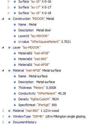

    I do have checked the "ROOM" part when I export it as gbXML file from Revit. I have tried to coorect the wall materials. But it turns out to that the "CADObjectID" always refers that wall is "Basic Roof: Generic - 12" , instead of showing the material I give. I have just attached part of the showing in gbXML file.  And I would like to know whether the material name of a surface will in appear in the list of "CADobject"? And could you recommend me some sources taliking about how gbXML interpretate the geometry and material information in the Revit.

    First of all, you should not worry about "CADObjectID". I dont know has that parameter change, however you should not focus on that because there is no library with "CADObjectID" so you cannot use it. I think that you should concentrate on the surface ATTRIBUTES. Every surface has attributes such "CONSTRUCTION". The Construction, Layer and Material nodes define to you all the essential information about the surfaces. These nodes are under the surface area in gbXML and are sibling nodes with Surface nodes.
    In odrer to see study the conection between gbXML and REVIT type on the search field of REVIT the word: gbXML. Go to the first result and you ll find what you need.
    In the gbXML you have posted there is sth wrong. I cant see any ATTRIBUTES in the Surface nodes. This atribbutes will guide you to the information about the materials layers and other construction parameters of every surface.

    1. I notice that each object has a CADObjectID. And the surfaces in my model, Basic roof: Generic - 12, and Basic wall: Generic - 8, Fixed: 36" x 48" for window. But do you mean we do not need care about all the CADObjectIDs? Are they related to the materials allocated?
    2. The following picture shows the construction, layer, and materials. (The model is only one room)  And it does not indicate which surface is using this construction. How can I know that?  And no these (construction, layer and material) information show under the surface. Do you mean I may have generated a wrong gbXML file without materials included?  Do you mean there should be ATTributes under each surface nodes?
    3.  When you say "search field of REVIT the word: gbXML. Go to the first result and you ll find what you need.", which website do you refer? I do not think I can find it......
    I have attached the RVT and gbXML file again....
