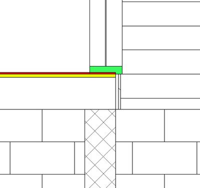

    Hello all,
    Curious how I can accomplish the following.  Any help would be greatly appreciated.
    My floor structure has a finish layer of carpet that's a 1/2" thick.  When I build this however, my doors and full height windows won't go down to the carpet, they'll go down to the sheathing and the carpet will cut in around it all.  So how do I get my carpet to cut itself out of the way of my doors/windows like it does with my walls?  Take a look at the pic (sans walls) to see the carpet intersecting with my frames.
    ~Wes~

    The way we typically do this is:
    Model the "carpet" (or other Finish material ) as a separate, individual floor, or floor(s)
    and edit the sketch of the floor at all transitions, such as doors, openings, changes in materials, etc.
    I don't think there is an easy way (or at all) to "cut" the floor's "carpet" or finish layer automatically.

    Another way in 2012 or 2013 is to use Parts, and then Divide Parts and assign different Materials to the Divided portions.
    This is a new approach, and has some advantages and disadvantages--depending on how you need to work and if you do quantity take-offs from Revit using Schedules--although this has improved in 2013's Parts function.

    oihadsf wrote:
    Thanks again Cliff.
    I'll check it out.  I haven't yet used parts in Revit, but did see that 2013 has upgraded their ease of use.  The main reason I want this working out properly is exactly for materials takeoff, so figuring a solid way to do it will help us out a lot.
    ~Wes~
    If it is primarily for materials takeoffs then parts might be a tough road to go down.  It is more of a challenge to get a material takeoff from a "mixed" model where in some case you are using parts and in other cases you are using elements such as floors.
    Out of curiouisity are your materials take offs so accurate as these cutouts would need to even be calculated?  I would assume the materials are ordered a lot more roughly than this and these kinds of cutouts are really just part of the "waste" assumed in the takeoff.
    I have done a couple of personal projects around my house and did really accurate takeoffs but still ended up with overage just because You can't really buy construction materials in super accurate quantities.  I have a box of hardwood flooring in my garage that is about 80% full to prove this.  I opened the box and used a couple of planks to finish the room.  Now I can't take it back.

    Jeff,
    Let me clarify, currently the way it is would be just fine for materials takeoff.  In no way would we dial it in to the exact square inch of material needed.  It's more so the visual problem with having the carpet not treat frames/doors/windows the same way it does with walls in 3D views and in sections.  Take a look at my section below.  The green is my window sill attaching to the floor, the red is the carpet cutting through my sill and yellow is my sheathing, in place and working great.  Ideally, my carpet would stop at the frame, but I can't get it to do that.  Per your comments, I'll forego using parts.  Making a secondary floor system of just carpet seems tedius but certainly more than simple enough to undertake.
    Thanks for the input,
    ~Wes~

    Wes,
    Parts is actually less tedious than multiple floors. You have a SINGLE floor object, but you can edit it's "layers"
    individually. You set your Views and View Templates to show "Parts, Original, or Both" depending on what you need to show in which views.
    You can easily create a Material Takeoff and specify Parts to get accurate quantities.
    You Create Parts, then Divide the "top layer" using sketch tools, just like editing the footprint of a floor sketch.
    Works like a charm. Give it a try, before throwing it out.

    Actually parts might be a really good option for you in this case if you are willing to take the quantity derived from the floor element and then use the parts elements to get the visual appearance you want.
