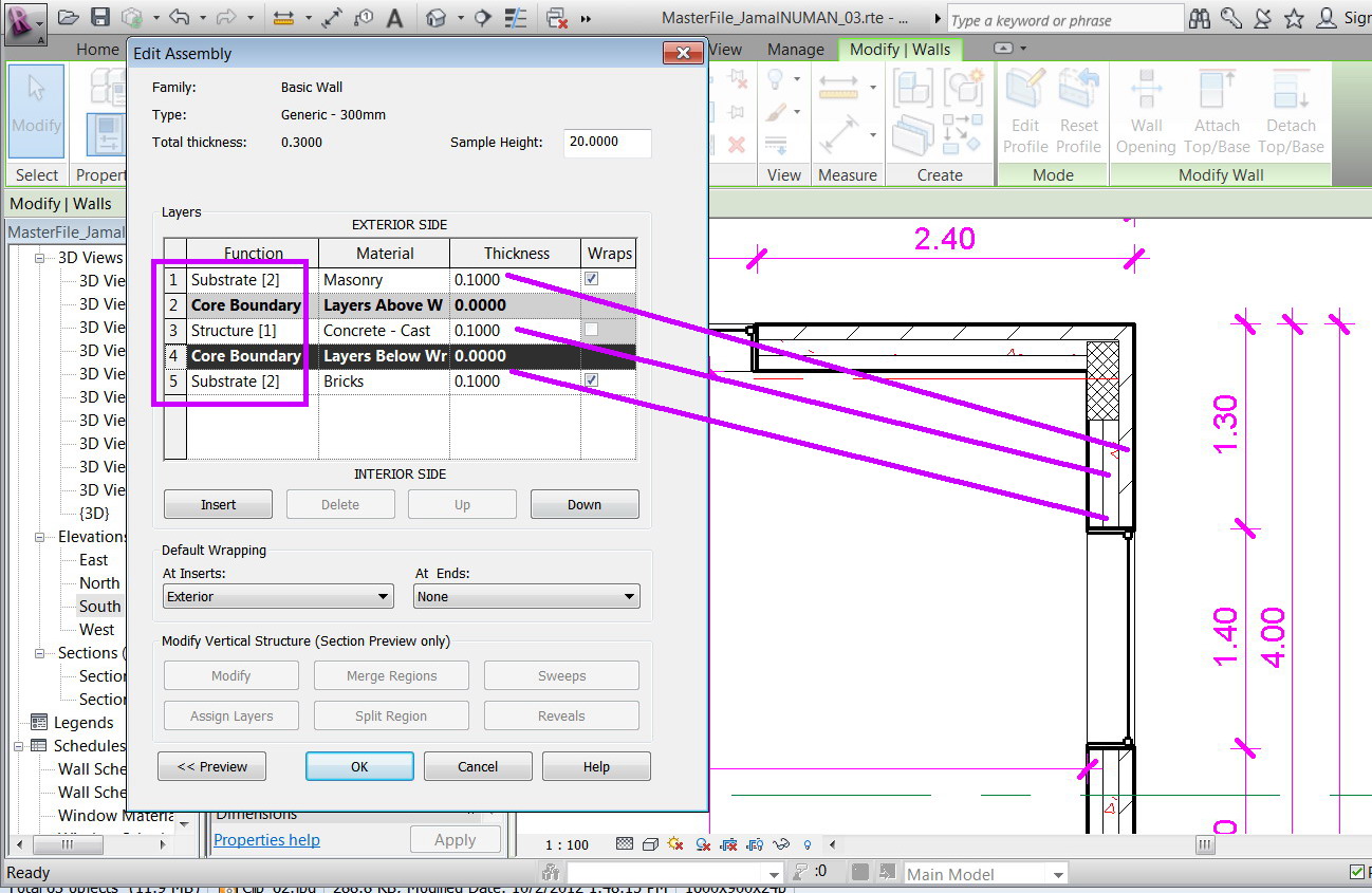

    What is the difference between these two settings for layers of a wall?
    230 Views, 4 Replies
    10-02-2012 01:51 PM
    I’m wondering what might be the effect of layering a particular wall in the two cases shown in the screenshots below (are they the same?):
    Thank you

    I would suggest you to go through some initial tutorials.
    It is well defined that any layer within Core Boundaries (grey lines) is the core structure of wall.
    Any layer outsite the core bounday is finish (Exterior finish on top side and Interior Finish on bottom side).
    A further detailed description is written in the tutorials.

    This is quite obvious for me. My question is about the effect of having a particular layer as core or not! What are the consequences?
    In my previous screenshots, the wall has the same layers with same functions! The layers are only different whether they are core or not! What is the effect of that? Could you give me just one example?

    The realtionship of where a layer is related to the "core" of the wall is really not critical.  The primary reason it is there is to allow for the use of "prefer" settings when dimensioning and selecting walls, and to help with layout by being able to define the wall justification to the "core" of the wall.  On a wall designated as "structural" if may have an effect on where the analitical line of the wall is created.  I am nto totally sure about that however because I do not often work withthe analitical structural model.

    Selection, dimensioning, lay out and analytical line, etc are affected by the classifying the layers of the wall as core or not.
    Despite the fact that I don’t know exactly how these items are affected by layer classifications (as core or not) but sounds to be logic.
