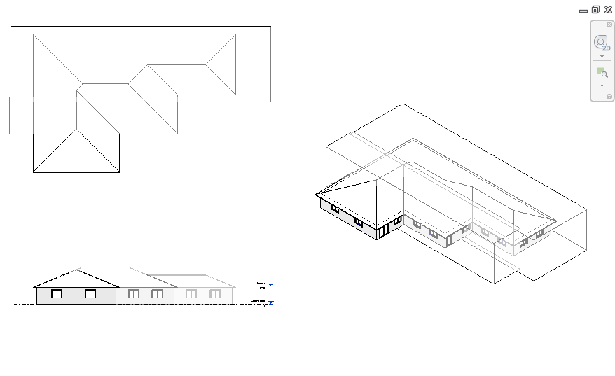

    So here's my question:
    How do you guys do to visually represent depth in an elevation?
    The only answer I've found is to use linework, but that can't be the way to go in a program such as revit. That's the whole point of it, right? To not have to sit and do things manually and then have to change the lines every time something in the building changes. I know that Archicad can show line thickness depending on distance from elevation line. And god do i dislike Archicad, but that's exactly what I'm looking for.
    Another answer I've found is to use shadows, but then you get the problem of only being able to print as raster = no sharp lines.
    So, anyone? I can't be the only one with this problem?

    There is one trick that works, but only for presentation elevations, meaning not actual elevations with annotations, but a "front" 3d view from the Cube. As shown in this image, a family that is just a sheet of glass with 50 % transparency, is placed among the model, separating it in parts, as per the depth. The front part of the house displays as it is. The second part is behind one sheet of glass, and displays lighter than the first part. The third part is behind two sheets of glass, and displays lighter than the second part, etc...

    Youn can also achieve the same result using masses.  In the visibility graphics for the elevation you can set the Mass > Form projection lines to be white so they don't show.  Also use filters to control which masses are visible for the different elevations.

    You can set up multiple elevations with limited view depths, then overlay the elevations on a single sheet. The first elevation can have all linework set to have thicker lines, the next to have medium lines, the third to have thinner lines etc. That way you can add annotations. Bit fiddly but the only way I've been able to achieve line weights in elevation. Agreed this is one aspect of revit which should have been fixed by now.

    Please look at the attachments in message # 2 and # 3 above. If we select the roof and make it halftone, the whole roof would become halftone, instead of having shades of gray as per the visual depth, as in those examples.
