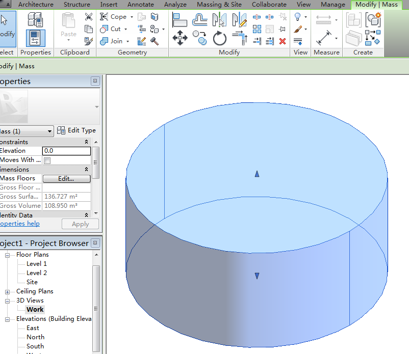

    I have been using revit for many versions, recently had a try on revit2013.  I found out that the ribbon menu/icon didn't update by itself when I selected a face of a mass. I have to manually refresh the ribbon bar (minimize/unfold) by double click it or click the tiny triangle to make the associated icons (e.g.. The divide surface button) appear. When I finish the editing of massing and quit the mass mode, the form element menu still left in the ribbon unless I manually refresh it again.1.PNG1.PNG2.PNG

    Hi Ross, I had nvidia 8800 with my pc for few years and it works fine with Revit2011 and Revit2012, and I try to turn off the Hardware Acceleration function and restart the revit the Ribbon issue persists, it also happens with my MBP2011. I guess revit 2013 is quite different when dealing the graphic hard problem

    I wanted to check in and confirm if this issue was still occurring? I had a few items to confirm:
    1. Second Monitor:  Are you using Revit 2013 on a second monitor? If so does the same behavior occur if Revit is on the primary monitor?
    2. Display Driver Management Software:  Could be related; we had an older issue where ribbon panels would be blocked by the display driver;http://revitoped.blogspot.com/2011/01/dept-of-huh-new-little-guy.html . One example is the nVidia option “Prevent windows from opening off-screen” in the post example above.  Test uninstalling any supplementary display driver software or disable specific management features to test.
    3. UIState.dat:  Does the issue persist if you make a copy, then delete your UIState.dat file? You can find this file at the following location:%APPDATA%\Autodesk\Revit\{Revit Product Name} 2013\UIState.dat
    4. .NET:  If the workstation has any beta or pre-release versions of .NET they should be un-installed.  Try installing the version of .NET instead which came with Revit 2013.
    5. Windows Registry:  We can reset some of the Revit 2013 registry defaults to see if the issue still persists. Please take care to first backup the Windows Registry so if needed you can restore it after you rename any folders. See the document here for that process :http://usa.autodesk.com/getdoc/id=TS66513
    Using the Windows Registry editor [Start > REGEDIT], right-click and rename the following registry folders (Panels_backup for example):
    HKEY_CURRENT_USER\Software\Autodesk\Revit\{Revit Product Name} 2013\Components\Panels
    HKEY_CURRENT_USER\Software\Autodesk\Revit\{Revit Product Name} 2013\Components\Dialogs
    Then launch Revit 2013 and see if the issue persists. Please let me know if any of these items change the behavior.

    Reinstalling .NET made it work better. Thanks!!
