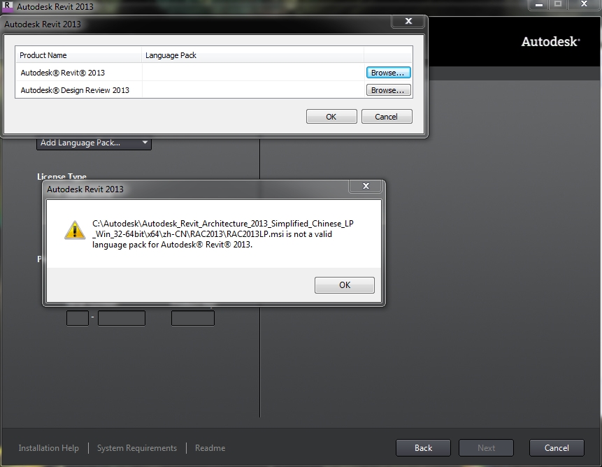

    Member
    Posts: 3
    Registered: ‎09-23-2012
    Re: Italian language pack for Revit 2013
    09-25-2012 03:08 PM in reply to: tony.michniewicz
    Hi, thanks for the reply, but it doesn't work. here pic. I downloaded the language pack Autodesk.REVIT 2013.jpg
