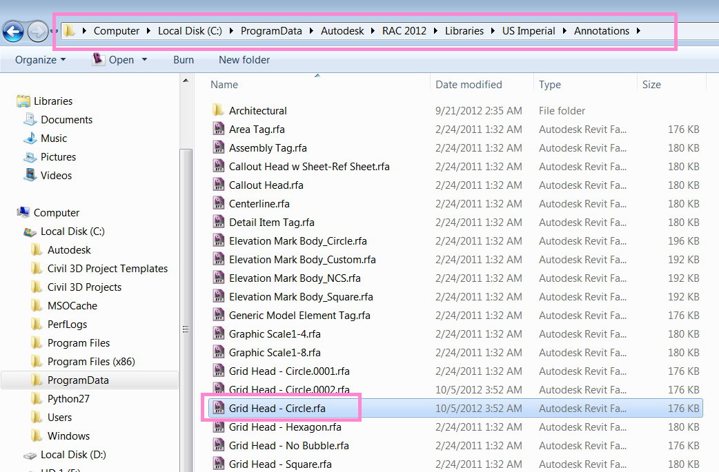

    1: Grids are part of a system family - you are not able to just edit it. You will need to open the family Grid Head - Circle and edit it to what you would like it to be. (first image below.) then you will need to re-load it into your project. Once loaded you can select an existing grid and get into the type properties and then specify the grid head family you just reloaded. (second image below)

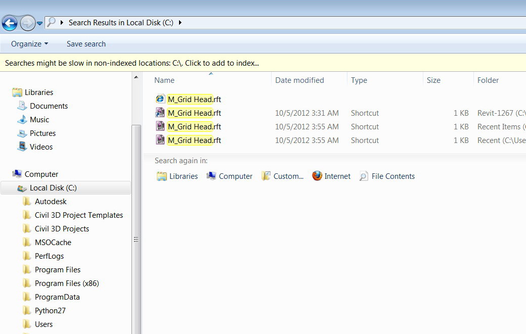

    1)     In my file, the name is “M_Grid Head – Circle” but not “Grid Head – Circle” while in the hard drive I could find the file “Grid Head - Circle.rfa” while the “M_Grid Head – Circle” is not there! Thus, changing the “Grid Head - Circle.rfa” doesn’t affect the size of circle!

    I am working out of the Imperial library - you are in the metric.
    Once you modify the one you are actually using in the metric library and load it into your project it should update.
