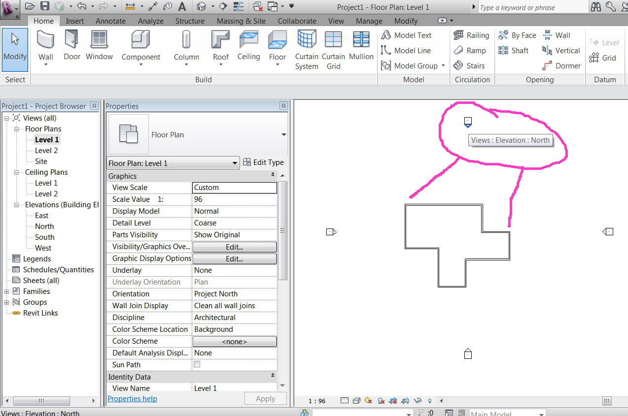

    Re: How to set the “height” of each floor?
    09-17-2012 01:01 PM in reply to: JamaL9722060
    JamaL9722060 wrote:
    "Then based on what these “levels” are located a distance from the body of the drawing? Does this also belong to the template we use?"
    Pretty much every aspect of a project is defined by the template, including the location of and the distance between the Elevation Symbols (as you asked about in another thread). Ideally, one would create a Project Template that includes such preferences and settings as well as any Families that are typically or frequently used.
    Corey D.                                                                                                                                                               LogoEE.png   AutoCAD user  Revit user
