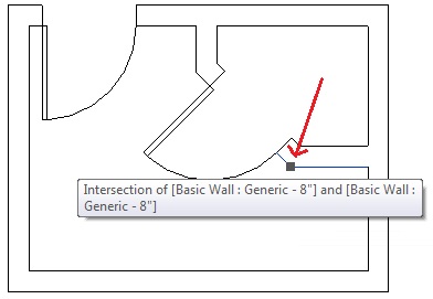

    Re: Doors in angled walls
    11-09-2012 12:26 PM in reply to: GRandall
    While using the Aligned Dimension tool, you can hover the cursor over the intersection of the faces of the angled Wall and another Wall, then hit Tab until the intersection point is highlighted (see image below). From there, you can then click on the center plane of the door and the opposite edge of the face of the Wall without trouble. You cannot select the intersection of the Wall center lines.

    Valued Contributor
    Posts: 80
    Registered: ‎05-28-2008
    11-09-2012 12:26 PM in reply to: ccollins
    Sort of. When the door is selected and the dimension is invoiked it only recognizes the jambs of the door. No wall points are available to snap to. I added other walls at differnt angles within this drawing and they functioned properly but none (30+) of the angled walls allow the exact placement of doors or dimensions.

    Valued Contributor
    Posts: 80
    11-09-2012 12:42 PM in reply to: CADastrophe
    Yes I can do that but under no circumstances do temporary dimensions function on the non ortho walls.
