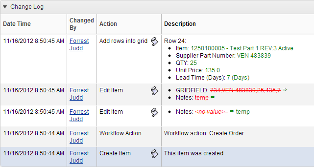

    I have a behavior that is doing the following:
    1. Iterate through all rows on a grid
    2. Collate grid rows corresponding to particular vendors
    3. Create new items in a different workspace, one for each unique vendor found in step 2
    4. Populate the grid of each item created in Step 3 with information from the original grid
    To accomplish this I have two scripts.  The first script does the collation and creates the new records.  As part of this, it passes information to the new records for building the new records' grids.
    The second script should run on new item creation in the second workspace.  This script parses the grid information passed from the original script and builds the grid.
    I have all the logic working for all aspects of the behavior, and it works great.  The only problem is that the second script is not running for every newly created record.  To attempt to resovle this, I changed the grid manipulation script to run on item edit instead, thinking maybe it was a timing issue.  It still doesn't work.Here's an example:
    The original record (an order record) has on it three line items.  There are two unique vendors that provide these items.  This means two purchase order records will be spawned.  I've tested this about 10 times now, and each time only one of the new PO records gets its grid populated.  The information to build the grid is being passed, but the grid is not building.  Here is the change log of the PO that worked:
    Notice that all record changes happened between 8:50:44 and 8:40:45.  Both scripts worked in conjunction perfecty.  The scripted Item Edit happening at 8:50:45 to change the Notes field is from a script that runs On Creation.  The other item edits (GRIDFIELD, notes, and grid row building) happen in a script that runs On Edit.
    Here's the change log from the second PO:
    Notice that this item was created at 8:50:45 as part of the original script, but that the item edit that should have occurred immediately (as a result of the On Create script) *did not* happen.  The Item Edit in the above log was manual, 3 minutes after it was created.  I did that to test that the script and data on the record was otherwise correct, and it is - the grid is successfully built.
    So my question is this - why is the On Create script not running for both records?

    If I understand you properly, a item created by a script is equivalent to an item being imported. Which boils down to the system not running a on creation script.
    The system is setup to do this for failsafe reasons.

    The rule for spawning is that only the first spawned item in each workspace within the same script will have its OnCreate script run.
    So for your particular case, you can easily work around the problem by adding all the code you want to the spawning script. It gets a bit tricky if there are multiple ways to spawn the same type of item and one of those ways is manual (direct). In that case, you need to add a condition to the OnCreate that will figure out how the item was created.
