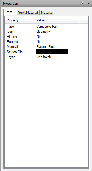

    Attached are 2 screenshots of the Properties palette for each light. Let me preface this by saying these 2 are the same family different type.  Fixture F-1 I can select the source itself. I has the material as the lens. Fixture F-2 I can only select the entire light (Fixture, body, pendant) and it has the material Plastic-Blue.
    Wierd?

    Thank you for the update.  By default the selection resolution in Navisworks is set to Last Object, so if your selection resolution is set to this, when you select the light source in the Navigation window, you’ll select the entire Light Object rather than the light source photometric web geometry.
    Looking at your screenshots, it may be the case as the type property states “composite” rather than Geometry.  The Light object will have a different material stated than the light source solid.   I checked with a sample file, and I find materials such as “Glass – White, High Luminance” and not “Default Light Source” for the light objects.  After setting the resolution to geometry and selecting the light source geometry, the material is then “Default Light Source.”
    Please try setting the selection resolution to geometry and try selecting the light source.  To set the selection resolution, slide out the “Select & Search” panel in the Home Tab.
    If the selection resolution is set to Geometry is the Material stated as Default Light Source?
    If so, then you should be able to run the Find Items query on that material to hide the extra light source geometry.

    That was my first thought till I did a search for "Default Light Source" and none were found.  See the attached screen shot showing the selection resolution at Geometry and the item properties showing Composite part and Plastic Blue. Also look at the lights on the screen. Some have different colored Light sources and others match the rest of the fixture. The blue lights on the right and the blue and gray lights on the left are the same Revit family, different types. The Square and can lights are "Stock" Revit lights.
    We keep a saved search for this and have used it quite successfully. But we have never done it from Revit 2011 to NW 2011 before.
