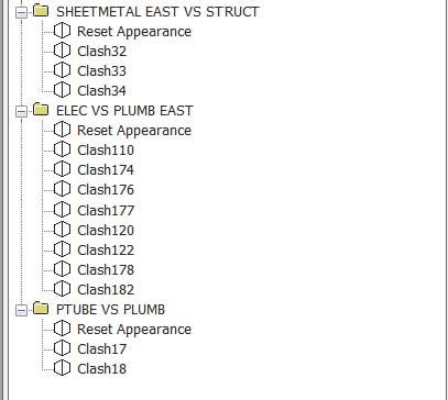

    I just installed this service pack.  Now when I run a clash report (as viewpoints),  the first viewpoint is "Reset Appearance", which I have never seen before.
    The remaining viewpoints  don't contain any review markups like clouded areas or text added while reviewing clashes.   Lastly I'm loosing all my transparency settings.  It seems just by creating a viewpoint report, it's automatically "unhiding all" of the subsequent saved viewpoints and and somehow resetting transparency.
    My "save/hide attributes" viewpoints settings  are checked (on).  No apperance profiler set up.  Saved viewpoints reports (from clashes) create before this SP2 are fine with no issues.  Any ideas are appreciated.

    I'm having the same issue as concrete1988.
    In addition, when I put the new Saved Viewpoint Clash Report folders into a single dated folder, the model turned into coordination view and would not return to regular view regardless of which tab I was on in the Clash Detection module (and even when the module was not open).
    I have uninstalled Service Pack 2.  It was so promising, but this issue completely undermined my workflow.

    I am experiencing the same issues described by concrete1988 and would like to add the following:
    1. The clash detective viewpoints created with SP2 increase the size of the published nwd's tremendously (approximately 15 MB per 300 clash viewpoints). An nwd with 3000 clashes which is typical on a heavy TI project level would become 150 MB.
    2. Not all the "reset appearance" viewpoints created actually work. Most retain the clash detective view.  The only way around it is to create your own saved viewpoint of the desired appearance and edit the viewpoint with the "save hide/required" and "override materials" boxes checked. This viewpoint can then be used to reset the appearance as needed.
