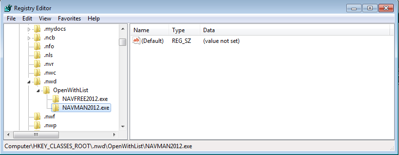

    Using the information from the article above, I created some keys for the different versions of Navisworks under the key: HKEY_CLASSES_ROOT\Applications
    1. Open Regedit
    2. Browse to HKEY_CLASSES_ROOT\Applications
    3. Right click it and select New > Key
    4. Name the key “NAVMAN2012.exe”
    5. Right click the newly created key, and select New > Key
    6. Enter the key name “shell”
    7. Right click the newly created key, and select New > Key
    8. Enter the key name “open”
    9. Right click the newly created key, and select New > Key
    10. Enter the key name “command”
    11. In the (Default) key of the command key, enter the following:
    C:\Program Files\Autodesk\Navisworks Manage 2012\roamer.exe "%1"
    Here is what it looks like in Regedit after creating keys for Freedom 2012 and Manage 2012:
    You can repeat the above for the other versions of Navisworks. For example, use NAVFREE2012.exe in step 4, and the following path in step 10:
    C:\Program Files\Autodesk\Navisworks Freedom 2012\roamer.exe "%1"
    Or if you have a previous 2011 version of Simulate installed:
    Use NAVSIM2011.exe in step 4, and the following path in step 10:
    C:\Program Files\Autodesk\Navisworks Simulate 2011\roamer.exe "%1"
    Now that the keys for the application versions are created, you can add an OpenWithList key to your .nwd, .nwf., .nwc extensions:
    1. In Regedit, browse to the key HKEY_CLASSES_ROOT\.nwd
    2. Right-click it and select New > Key
    3. Name the key OpenWithList
    4. Right-click the “OpenWithList” key and select New > Key
    5. Enter the name NAVMAN2012.exe
    6. Repeat steps 4 and 5 to add the other application versions that you created in the Applications key
    You can repeat the above for the HKEY_CLASSES_ROOT\.nwc, and HKEY_CLASSES_ROOT\.nwf keys.
    Now, when you right-click an NWD and select “Open with”, you’ll see the Manage and Freedom Icons.  If you want to set one to default when you double click a file, click the choose default program, select one from the Recommended Programs list, and with the “”Always use the select program” box marked, click OK.
