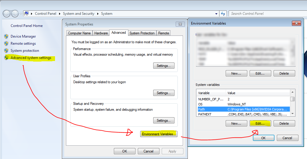

    I guess I should have combined all my questions, but I ran into another wall
    9. Add PHP to the system path. (C:\Program Files\Autodesk\Autodesk Infrastructure Web Server Extension 2013\Php) Then, you will need to restart Windows.
    where and how do you do this i.e. add PHP to the system path. I am assuming I need to exit the inetmgr dialog and enter this in the windows Environment Variables

    Posts: 242
    Registered: ‎10-06-2008
    Re: IIS and Mapserver2013
    07-11-2012 08:31 PM in reply to: Sam-I-am
    Right click "My Computer" and follow this (screenshot is Windows 7, pretty much the similar for other versions)
    - Jackie
