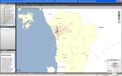

need help..i linked my system (image1) to google map (image 2)..from the system(image 1), i did selected a parcel and then link it to google map hoping that the selected parcel will be zoom on the google map..but it seem that google map does not read the selected parcel...what went wrong?is there any setting to make sure that googlemap can read my selected features from the mapguide?where can i find the setting?..hope u guys can understand my question..thx in advance..

it seems that i overlooked the initial view coordinate in the google map coding. the one that i used actually covered larger area, so i changed the coordinate that fit to the zoom in scale.
