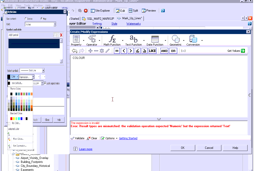

    Hi All,
    I have a database full of string colours:  0xFFFF00FF etc
    If I copy and paste this value for my Enhanced Styles it works fine for value, but if I choose the column I get Not A Number Error.  There is no TOHEX function... Sorry for the cross-post but this is a AIMS 2012 issue too

    Solved it.  You have to store you colours from ARGB for example RED FF FF 00 00 (hex) in Long Int in the database or mapguide can't see it.
    So just convert your data in the database to Long Int (FFFF0000) which is 4294901760  and Black is 0
    Crazy way to do it, but there you are.

    I could find a solution:
    The attribute with the color-code (in integer) in the database should be from type string. It's a bit confusing, but that's how it works.
    Hope it works for you as well.
