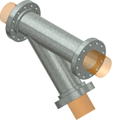

    When creating a piping part, like a strainer, I'd like to be able to show something to represent the area that needs to be kept clear to allow for removal of the filter cartridge.  In AutoCAD I'd just draw a phantom circle and a few lines extending from it to show the needed room.  Does anyone have a suggestion of a way to indicate the area in an Inventor part that won't obscure parts of the main object or other objects that may be located behind?  Transparent solids, or maybe sketch entities?  It's primarily needed for design, but if it can show up in the 2D drawing (without totally blocking what's behind it) it would be a plus.
    See the attached file for an example of what we've been doing in our AutoCAD models.

    I think you can sketch a circle and extrude it as a surface (rather than a solid) in your part model, and use this for your needs. Surfaces will not show in the drawing views by default but can be turned on, and you can turn their visibility off in the part model as needed also.
    I often use surfaces such as this as "helper" geometry to make constraining part models quicker.

    Curtis, I think extruding surfaces will be our best bet.
    Thanks to all for your suggestions, they are very much appreciated!
