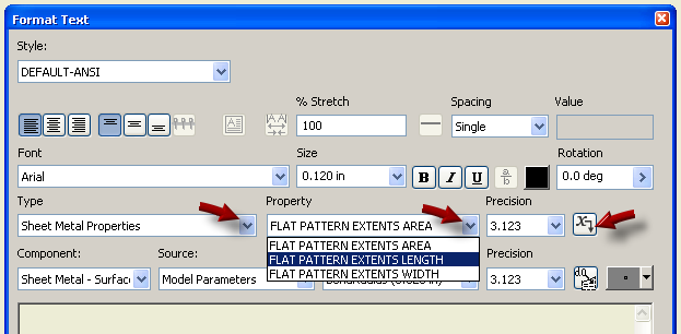

    I am using IV ultimate 2013
    Hi just found about this add-in:http://modthemachine.typepad.com/my_weblog/2012/05/sheet-metal-extents-add-in-update.html
    But its not working for me:
    I ran the installer
    created a sheet metal part and hit rebuild all, it did not create any proeprties, also tried to manually create the properteis then hit rebuild, no go.
    I also did a search on my hardrive for the ApplicationPlugins, and placed the sheet metal folder in all of them(there were 3)
    tried again noto.
    The add-in also does not appear in the add-in manager.
    Any Ideas
    Or is there differnt wat to get the flat pattern dimensions in 2013
    TIA!

    Hi omartin,
    If your goal is to show the flat pattern extents on the drawing then indeed this is built into Inventor now. You can do so by using the Text tool and pulling the Sheet Metal Properties as shown here.
    I hope this helps.
    Curtis

    Hey Curtis thanks for they reply.
    But I plan on showing it in the BOM, Ideally it would be in the fxParameters (which I think this add-in supports)
    But I have some custom variables in my BOM that I use, and I am hoping I can point to those custom properties.
    I will keep on trying to figure it out.

    Hi omartin,
    If it helps, you can create a simple iLogic rule to place the extents information into custom iProperties that can be used in the BOM & Parts List. Attached is example with the rule placed in the part, but I'd recommend creating the rule as an external rule, so you can have it run on all sheet metal parts when they are saved, etc.
    http://inventortrenches.blogspot.com/2012/01/creating-basic-ilogic-rule-with-event.html

    I hope this helps.
    Curtis
