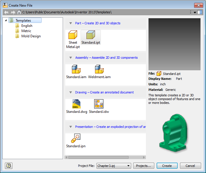

    Just to be sure -
    can you attach screen shot like this

    I see Standard (in).ipt, not Standard.ipt
    Are you clicking directly on 1
    or
    are you clicking on 2 first and selecting a template?

    Ah_ha it was the part file...that worked!
