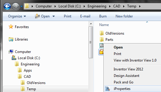

    If you RCon the file in windows explorer and select properties, click ok then this dialog window comes up.
    Then just select "iPROPERTIES and the dialog that comes up with mimic the one you see inside of Inventor.

    I don';t know what version you are using, but I pretty sure the method below works for the last 3 realses of Inventor.
    If you RMB click the file and select properties, there should be an IProperties tab you can select.  There is a button which will open the Iproperties for that file.

    Can you not just right click on the file in Explorer and select iProperties?

    I suspect what you're wanting is a way to view the iProperties in the meta-data grid that is available in Windows Explorer and the Open dialog when the view is set to Details.
    Unfortunatly, I'm not aware of a way to do so. But maybe someone else knows of an add-in or trick.

    I am sorry for not being more clear. I am aware of the right click, I was more curious of getting the properties to display in the grid. Does that make since?
    For example, I would like to see Project and Part number iProperties displayed in the properties grid to easily sort through files. Or even more so, I would like to see custom iProrperties displayed in the grid. Right now, I only see a way to have the standard windows properties.
