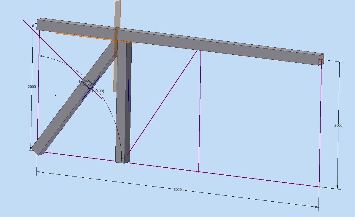

    Hi all!
    I`m starting to learn about iLogic, and have a couple of questions regarding this matter.
    I`m using adaptive planes and the split command to cut the pipes to each other. After the cut plane is constrained I want the plane to be turned off automatically.
    To achieve this I`v tried using a if command, without luck obviously.
    IfConstraint.IsActive("all the parts to look in", "Work plane 3") Then
    Feature.IsActive("that specific part", "Work plane 3")=False
    Else
    Feature
    .IsActive("that specific part" , "Work plane 3")=True
    EndIf
    Is this possible?

    Have been trying out some codes, without luck.
    'define document
    Dim oDoc As PartDocument
    oDoc = ThisDoc.Document
    'look at the workplane collection
    For Each oWorkPlane In oDoc.ComponentDefinition.WorkPlanes
    If oWorkPlane.Constraint.IsActive("Mate:1")=True Then
    oWorkPlane.Visible =False
    ElseIf oWorkPlane.Visible=False Then
    oWorkPlane.Visible=True
    EndIf
    Next
    Here`s the message I get.
    Error in rule: Rule0, in document: Assembly5.iam
    Unable to cast COM object of type 'System.__ComObject' to interface type 'Inventor.PartDocument'. This operation failed because the QueryInterface call on the COM component for the interface with IID '{29F0D463-C114-11D2-B77F-0060B0F159EF}' failed due to the following error: No such interface supported (Exception from HRESULT: 0x80004002 (E_NOINTERFACE)).
    Any ideas whats wrong?

    Posts: 24
    Registered: ‎01-16-2013
    Re: iLogic commands!
    02-05-2013 11:37 AM in reply to: Curtis_Waguespack
    This one has slipped my mind.
    The tilted part has 2 planes (within the part, not the assembly) and these two planes are constrained to the other parts. When they are constrained I would like to turn off the visibility. Horrible explanation, but did you get it?
