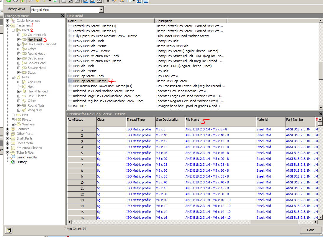

    I have the example working which will replace Bolts:
    ref: http://forums.autodesk.com/t5/Autodesk-Inventor/Changing-C-C-component-Automation/td-p/2736623

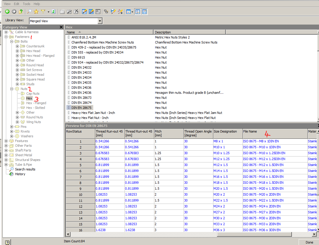

    but swapping the code to replace nuts is giving me grief. How do you identify the content center paths?
    ie I have tried:
    replacer.Replace("nut:1", "Fasteners:Nuts:Hex", "ISO 8675 - M30 x 2DIN EN")
    replacer.Replace("nut:1", "Fasteners:Nuts:Hex", "ISO 8675 - M30 x 2")
    replacer.Replace("nut:1", "Fasteners:Nuts:Hex ", "DIN EN 28675 M30 x 2")
    Thanks MES

    I now have this working  - but have failed at the next step - swapping out from a custom content center.

    I try to do a similar replace from content center but I keep getting an error that content center family is not found.
    I have read all related posts and tried many things, im out of ideas.
    I might do something entirely wrong or I might just have a small typo, but the result is still the same error.
    Any help would be great. See attachment
    Thanks in advance,
    Arnold

    12-21-2012 01:39 AM in reply to: MarkESmith
    Seems to be nothing more then a typo.
    What I did was to add the nut in the content center to favorites. This way you can right click and rename it.
    Use this to copy the foldernames and the partname so you dont have any chance of a typo. Though I didnt see any typo, it works now.
