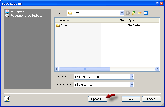

    I think you can click the Options button when saving out the STL file and set the *.stl units to match your document units.
    Note that this has changed over the years, so if you don't see the option it might be due to the version of Inventor you're using (I seem to recall a bug with this in earlier versions).

    To clarify, I think you'll need to re-save the file as an STL and use the Options button to ensure the units are set correctly:

    Or how do you get the dialog save copy as?

    From within Autodesk Inventor
    Select Save AsSave Copy As, then use the Options button shown previously.

    It has been reported here many time (a search might turn up previous threads) that the Options>Units must be set on saving stl files.
    Unfortunately it has also been reported here (a search might turn up previous threads) that Inventor Import of stl cannot be relied on as a check of size as Inventor does not import the files correct units in some cases.
    There are other software programs that can be used to verify the geometry size.
    The best bet is to indicate to the person who will run the job what the bounding box size for the part should be.
