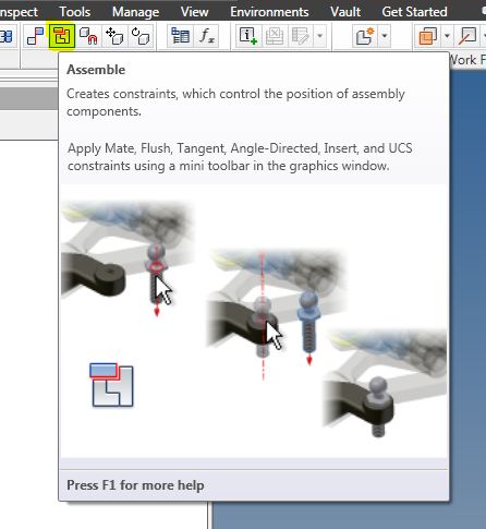

    If I understand your issue correctly, I have had more luck using this command when it comes to situations like yours.
