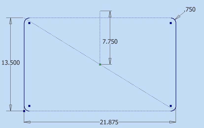

    Step 1 create rectangle and then diagonal line as shown.
    Then add coincident costraint between midpoint an origin (don't use the horizontal and vertical constraint as shown in the video, it would work and doesn't really matter in this case, but develop a better technique.  In 2013 there is a centerpoint rectangle to do this for you.  For 2012 there is a centerpoint rectangle Add-in avialable somewhere (a Google search should turn up the download link.))
    Please use plain text.
    *Expert Elite*
    Posts: 21,724
    Registered: ‎04-20-2006
    Re: WHY WONT THIS SHAPE EXTRUDE
    10-24-2012 08:41 AM in reply to: JDMather
    Dimension the rectangle with the dimensions as shown.
    Add R.75 fillet to the four corners.
    Add vertical 7.75 line as shown.
    *Expert Elite*
    Posts: 21,724
    10-24-2012 08:44 AM in reply to: JDMather
    Using crossing window (right to left) select these lines and change to construction.
    *Expert Elite*
    Posts: 21,724
    10-24-2012 08:48 AM in reply to: JDMather

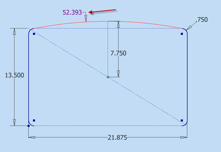

    On the next step the YouTube shows this arc as NOT tanget, so we'll assume that is the design intent.
    Create a 3-point arc at the endpoints of the fillets as beginning and ending point and the the end of the 7.75 construction line as the third point.
    *Expert Elite*
    Posts: 21,724
    10-24-2012 09:22 AM in reply to: JDMather
    Now just fun - dimension this arc (it should already be fully constrained).  See where the YouTube got that silly dimension.
    Much easier to type 7.75
    Create  the same arc at bottom but just click in space for the third point and then make the two arc Equal (=) constraint/.
    (don't dimension, don't mirror)
