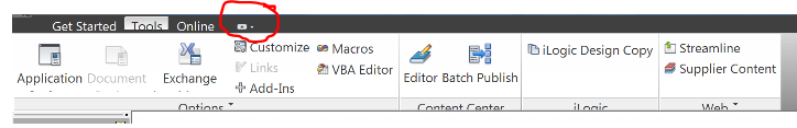

    I have just installed Inventor 2013.  How can I fix the UI Ribbon cutting off button text?  I have attached a photo demonstrating the problem.  I cropped the screen shot to only show the ribbon to cut down on excessive image size.

    09-23-2012 02:12 PM in reply to: gordon
    Click here 3 times and see if that helps
    Is your video card/driver up-to-date?

    Re: UI Ribbon buttons -- text is cut off
    09-23-2012 02:17 PM in reply to: JDMather
    I tried that and cycled through hiding the ribbon until it showed up again.  It didn't change anything.  The words are still clipped and the bottom of the text is still cut off.
    Yes, my video drivers are up to date.
    09-23-2012 03:44 PM in reply to: gordon
    Are use using "recommended" monitor/screen resolution and your text size is set to standard on your system screen/display settings.
    09-24-2012 08:38 AM in reply to: blair
    Well, my resolution is 2560x1600 on a 30" Panel.  I have Windows font size set to the preset of large.
    I would assume that a Windows 7 font size preset would be "recommended" right?
    However, it seems like dynamic button sizes would be a pretty essential feature.  I don't see any options to adjust font sizes in preferences either.
    09-24-2012 09:06 AM in reply to: gordon
    Not sure what the native resolution for your monitor is, but try setting the text size to (Smaller - 100% (default)) on your system. If you have set it to larger you could be cutting off part of the Ribbon.
    09-24-2012 09:14 AM in reply to: blair
    The native resolution on my panel is 2560x1600.
    The smaller preset is too small for 2560x1600 resolution.  There are twice as many pixels on the screen compared to 1080p.
    I will check to see if that makes the ribbon text work, but that won't fix my issue because then I won't be able to read anything else on my computer.  Maybe this should be marked as a bug?  Is there a public bug tracker?
