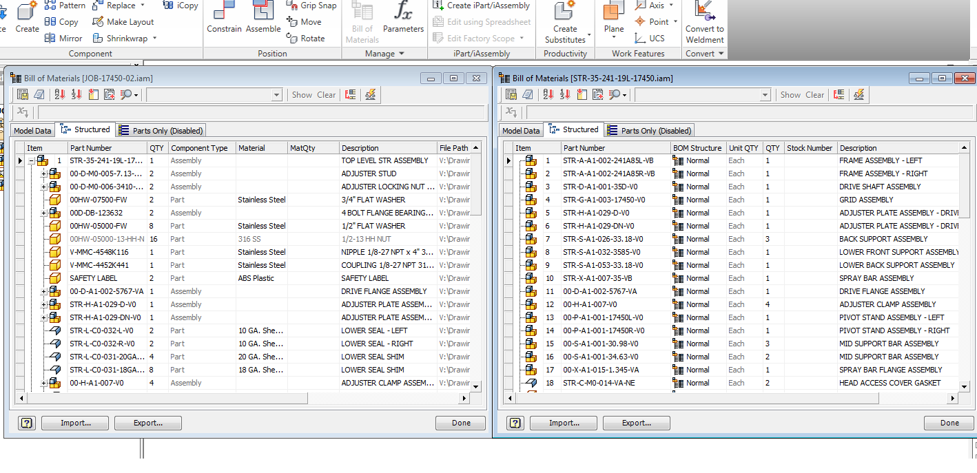

    I'm having an issue with the order of my BOM. In the picture below I have an assembly with subassembly STR-35-241-19L-17450. The BOM for the subassembly is on the right in the picture and is ordered the way it should be. However when I open the BOM in the Top level assembly (left in the picture) the order is not the same. In fact the order is completely random for the subassembly. I need this order to match the subassembly so I can export it into our ERP system.

    My list is sorted correctly with in the subassembly. Sorting the top level assembly will sort by item number but the item numbers are not correct.
    For example Item 1 in the subassembly is not Item 1.1 in the top level assembly.
    I would like Item 1 in subassembly STR-35-241-19L-17450 to be Item 1.1 in the top level assembly and Item 2 to to be Item 1.2 and so on.

    Sorry I don't think I'm explaining this real well. I have "all levels" showing and that is where the problem is. The second level is not in the order of the second level assembly.
    I attached the image to give you a better idea. In the picture I have 2 instances of Inventor running. The left is the BOM from the top level assembly. It has one subassembly shown with its children shown. The right BOM is that subassembly opened by itself in another instance. It does not have all levels shown because I just wanted to show Item numbers.
    For example: in the top level assembly BOM
    Item 1 = STR-35-241-19L-17450
    Item 1.1 = 00-D-M0-005-7.13-V0-316 (should be STR-A-A1-002-241A85L-VB)
    Item 1.2 = 00-D-M0-006-3410-V0-316 (should be STR-A-A1-002-241A85R-VB)
    Item 1.3 = 00HW-07500-FW (should be STR-D-A1-001-35D-V0)
    etc...
    Thanks for the help

    From your picture, you have the sub assembly BOM sorted by Part Number.  Your top level is sorted by item number.
    Try sorting your top level iam by Part Number and re-number the BOM.
    Item numbers are driven by sort order and sort column.  They are local to the specfic file and do not cascade from a parent to a child.  Also, you can have different item numbers and sort orders between the BOM of an iam file and the Parts List on an idw of that iam.

    It sounds like there is no way to have the orders match since the sort order does not cascade from parent to child. I was afraid of this because each BOM is sorted manually and not in alpabetic order. That means the only way to create a master BOM that matches all the drawings is to manually sort about 700 part numbers.
    It just surprises me that its done this way. Perhaps I can write some kind of iLogic that sorts the order properly.
