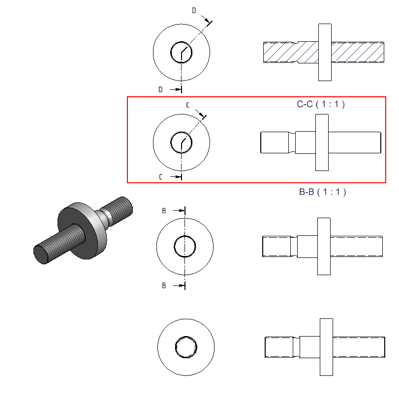

    I seen lots of posts regarding thread lines and features in drawing, but I did not find anything conclusive that answers my specific situation.
    Here is the issue we have found. While sectioning a view of an assembly in idw, the threaded lines of threaded features have a strange behavior depending on the section line used. I have attached a simple example that shows what he have found. Basically, if the section line is straight, threaded features show correctely. Independent of section participation. If the section has segments at different angles, then lines are not appearing.
    The first three views have both parts excluded from section participation(Obviously, there isn't any real life need for this, but I did it to just simplify the illustration without adding a bunch extra parts) The base view is the top view or view showing the round shape. For the first example at the bottom, i simply projected the view to the left and made sure "Threaded Features" was selected. Threaded lines show fine.
    Second example is the similiar, except the i used a section view instead of the projected view. Both parts are excluded. Section line is straight. Verticle in this example. Doesn't have to vertical as the line is straight.
    Next example is similiar to the second, only difference is the section is not straight. You can see the threaded lines do not show. This is the problem we want to solve. How to make the threaded lines display!!!
    Last example shows the same section, only this time the component is included in the section participation. And it works.
    If anyone knows of a setting to change or a trick to make it work, it would be greatly appreciated. Otherwise, i think i need to issue a support request with autodesk.

    Thanks for the reply. What happens if you exclude the threaded part from the section? and only section the ring?
    I am able to get the same result you did in the very top example in my image. I have the problem on parts i do not want to participate in the section. Like the example boxed in red. I need the threaded lines in this type of view. My display options are the same as yours.

    The only way that I can think of to exclude the mid section or other end is to construct that part as small assembly and then sections, using the options in the

    You are almost there. Do you notice how the threads only showed on the sectioned part of your view? How would you now make the threaded lines appear on the unsectioned part of the view.

    Would you mind taking a look at the attached file? It is inventor 2012 format. How would you recomend displaying the thread lines in section view c-c?

    See attached with orignal and section view-1.idw with note below each giving changes.

    Awesome Paul!
    I didn't think to turn on hidden lines to disply threaded features, but it works!
