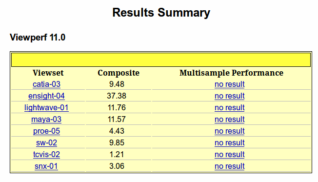

    *Double facepalm* did you even watch the link I posted????
    You are totally misguided, the benchmark results and tools used that you are showing are optimized for real-time rendering/computing for games and processing.
    OFF Topic:
    What is the fastest nvidia GPU Card?
    Answer:
    GTX 690
    Yes it even has a lot of Cuda cores but still the computing/simulation process of a Geforce and Quadro is very different.
    But why is the gtx 690 did not rank higher than other gtx 600 series  according to your link http://www.videocardbenchmark.net/high_end_gpus.html it’s because this website is ranked to “Price and Performance” “”ratio”” so even if gtx 690 ranked 9999th placed it doesn’t mean its very slow. I know this site because I also personally use this site whenever I plan to buy a Geforce card to render videos using cuda
    So even if we are comparing geforce cards for example like:
    scores
    gtx 690  = 3,537
    gtx 680 = 4,033
     just because gtx 680 got 4,033 points and ranked 2nd as of October 2. 2012 and gtx 690 scored 3,537 and ranked 9th  it doest mean gtx 680 is faster and everyone knows for a fact gtx 690 is faster than 680. Again the website averages a “Price and Performance” “”ratio”” to score……..
    About the directx 11 you said let’s say you have gtx 295 a directx10 card vs gts 450 directx11.
    Gtx 295 is a very very fast and older card and it will beat the newer series gts 450 on a directx 10 software but if the applications requires unique tessellation computing that exist in direct11 card the gtx 295 will surely lose an or wont even run it it doesn’t have the technology how to approach it.
    same situation like
    quadro fx 4800 is faster than quadro 600 but different architecture certain features that quadro 600 has that fx4800 doesnt. so its not always about specs.. it really depends how you utilize your workstation old card to a newer software that is not fully optimized because of older cards, vice versa
    Back To Topic
    what do you mean they don’t use directx??? A lot of windows applications use directx even some simple windows application uses a simple api like directdraw uses directx. Autodesk products even requires you to install/to have directx runtimes before you are allowed to install any autodesk product….
    If you want to make a proper, professional benchmarking opengl for a workstation then go to this site:  http://www.spec.org/gwpg/gpc.static/vp11info.html
    And here are some benchmarks results I googled for your gtx 560 ti
    Quadro 600
    GTX 560 ti
    2X GTX 560 Ti SLi
    http://mbah.net/2012/04/08/specviewperf-11-benchmark-results/
    Even a Dual gtx 560 ti that costs $450+ barely beats a $150 quadro 600 card..........
    and again watch these videos because it recreates the performance/simulation of your graphics card in the viewport of professional software like autodesk
    https://www.youtube.com/watch?v=phZ3XMfzL5I
    https://www.youtube.com/watch?v=DpUNa_C2ldE
