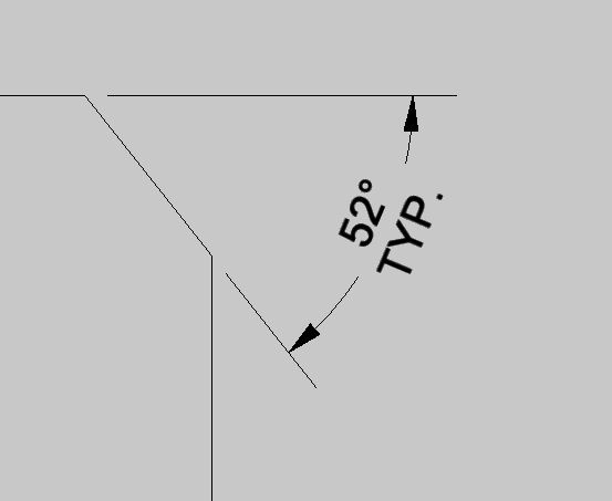

    Hello All
    what I am needing help with is, is it possible to have text below the angular dimension line like you can with most other dimensions. The attached pic shows my 10 dimension with the typ. Under the line and my 30 dimension with typ. Under the line but the typ. Under the 30 is just a text box I eye-balled in to place it is not attached to the dimension. I looked in the styles editor but could not find the setup option I need. Any suggestions?
    Cheers
    Andy

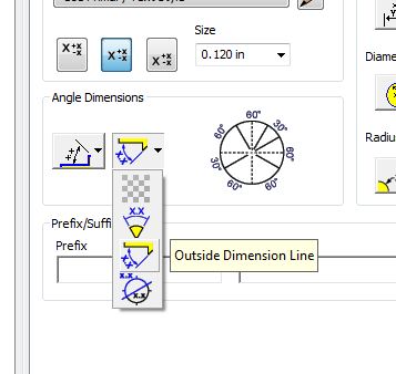

    Don't use TYP. If you tried to use that at my last job you would be fired. :smileyhappy:
    But to answer your question yes. This is one setting
    But if you go to your style and standard in that Dimension Style and change it to Inline-Aligned you will get the look you want.
    This will give you this
    Oh just incase all you have to do is dbl click on the Dimension then type it in

    Thanks for the reply James, I did notice the inline aligned option but as you see it cuts through the dim line, and like you said about the TYP. the drawing office can be real picky when it comes to things like this.

    Then use this one
    Gives you this

    And if you want it below pick this
    Give you this
