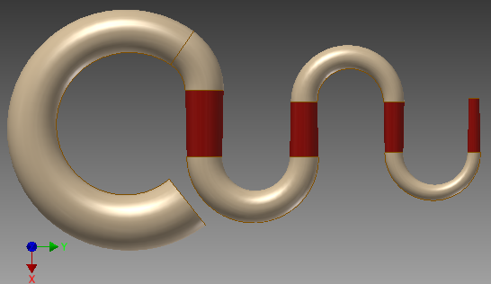

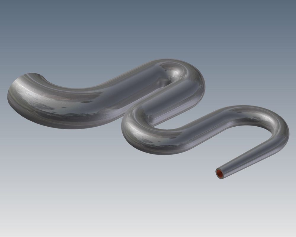

    The path sketch in your centreline-1.ipt is better than that in centreline.ipt, but it's still not tangent-continuous.  Edit the sketch and hit F8 to show all constraints.  Four tangent constraints are missing as indicated below.
    Once you make the path tangent-continuous (See centreline-gc-tangent.ipt), either sweep or loft will be successful.  It is important to make the path tangent-continuous for tapered sweep and centerline loft.  As many other users suggested, always make your sketches fully constrained.
    In ASM (the geometric modeling engine for Inventor, AutoCAD, etc.), sweep can take either taper angle or taper distance.  In your model, you want the radius of the circular profile to change from 56 mm to 10.5 mm, so the taper distance is -45.5 mm.  Inventor can take a taper angle, but not taper distance.  Here's a formula that computes the taper angle when the taper distance and path length are given:
    taperAngle = arctan( taperDistance / pathLength )
    You can use the Measure Loop tool to obtain the path length.  In centreline-gc-tangent.ipt, the path length is 2149.09641 mm.  The taper angle is then acrtan(-45.5 mm / 2149.09641 mm) = -1.2128672 deg.  If you sweep the large circle using this taper angle, the diameter of the end cap face will be the desired 21 mm.  See centreline-gc-sweep.ipt
    For the lateral faces, sweep creates five spline faces and four cones shown in red above.  Analytical geometry such as cone, cylinder, and torus is much lighter and faster than spline surface.
    Loft creates a single lateral face which is a long spline face as shown below.  See centreline-gc-loft.ipt
