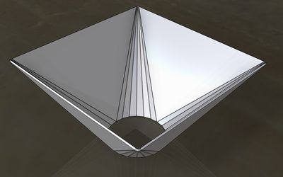

    Hello all,
    I have a square to round transition that I need formed up and the shop is telling me that they would prefer to split this thing at the corners rather than the flats. I've tried two different ways of doing this and I am looking for some input on how you guys would handle this part. It's 10.75" OD at the bottom and 2'-4" square at the top and 1'3" in length and made of 1/4" stainless steel plate. The shop wants this in four bent pieces that they can weld together down the corners.
    I've tried making just the one side but I'm not getting the results I would like to see. Making the full transition (as in the picture above) gives the finished result I am looking for but I can't seperate it into multiple sides.
    Any ideas on what else I can try?

    You could add a rip down one face of the full model and then add a cut feature to the flat pattern to leave just 1/4 of it.
    (why they want to do 2 extra welds and try to get a bend right on an edge is beyond me)

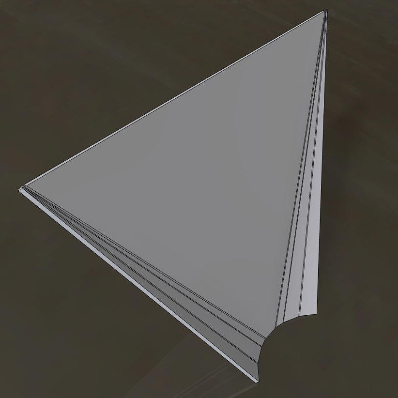

    This is what I get when I model just the one side. The corners aren't right, they wouldn't be cut out like this in real life.sinlge plate model.jpg
    I've also tried trimming the solid (won't flatten) and ripping all four corners to get the flat pattern I need (but the folded model still shows all four sides).
    I appreciate the help immensely. Any chance you can elaborate on your post above or help a guy out further?

    Splitting it in the corners is 4 welds.  Splitting it on the each flat is also 4 welds. - no difference.
    Splitting it in the corners will be a nightmare to press right on the edge of the plate.  Splititng it on the flats will be much easier to press to 90deg.  They shouldnt hit the machine on a 90deg bend.
    You could try a very thin rip feature down the middle of the bend and then use an extruded cut to delete the unwanted pieces and then create your assembly.
    Or you could create  your 1/4 model from middle of flat to middle of flat so that the full corner is in the part, then split it down the middle of the corner and then mirror the solid.

    Yep. Seems logical to me as well. I spoke to the guy welding it up and he said it would be easier this way too because then he wouldn't have to brace it/tack it to the floor when he put it together. If the pieces were 90 degree corners they would stand up on their own and he could just weld the thing.
    This, however, worked like a CHAMP!! I wrote off the split tool when it didn't work in my second test but it worked on just the corner part. I would have never thought of this and I thank you for your persistance. Please go tell your boss that I said you deserve a raise.
