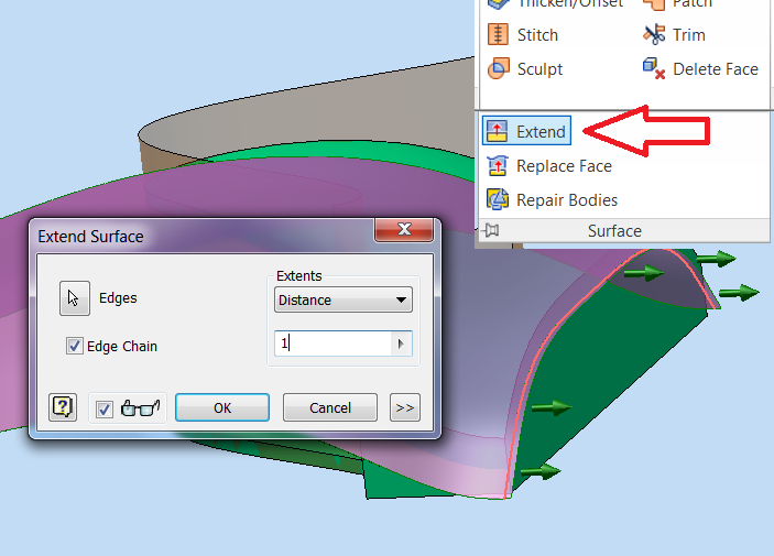

    Extend the edge of the surface.
    It must completely cut the solid.
    Also, Sketches 4,6 & 8 are not fully constrained.  Add construction line from projected orgin to midpoint of splines.
