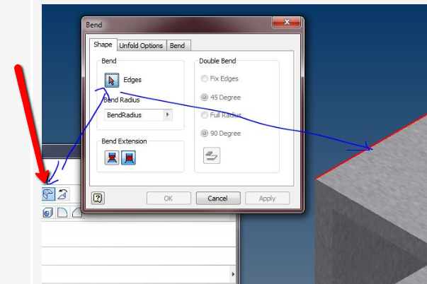

    Not sure how the part was made but it sounds like it was extruded not using shet metal functions.
    But putting in radius is not a way to fix it.
    in sheet metal there is a command called Bend use that just pick the edge you want. it will make it a bend with the sheet metal radius.

    What is this you are clicking?
    I dont recognize that.  I am on 2013.
    When I try the Bend command, I get an error when I apply it "Failed to extend body or create space for bend".

    I had never used the bend feature before to do this, but I tried it on '13 and it worked for me.

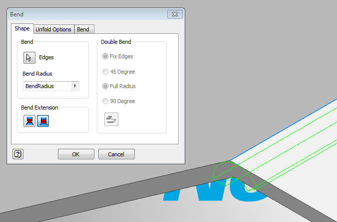

    sounds like your radius may be to big or flange to small to accept radius. can you post picture of yours? When it is in preview. like my second picture.
