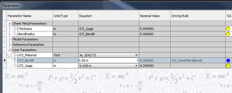

    OK, I wanted to start this one new in hopes of the resulting resolution (do I have faith in my fellow users here or what?) will be easier to navigate for others who search for this later.
    I have the need to create a custom Sheet Metal Part template or at least a template with the following custom sheet metal properties embedded. I'm currently trying to accomplish thi by using iLogic but it's hit or miss and I'm thinking this is way beyond my current novice abilities on iLogic.
    So attached is a screen shot of one of the 4 materials my client uses and their required bend radii.
    I'm asking any of you sheet metal and/or iLogic gurus to take a look and guide me thru this if you can.
    I don't want you to simply do it for me, I want to learn how by doing. But if it's easier for you to do it and then explain, by all means. I'm still going to redo it myself so I can learn it.
    Thanks in advance
    Jim

    I just create new items within the Styles for the Sheet-metal. I have different thickness and you can set the desired bend radius in the "Bend Tab". You start with the basic Sheet-Metal template and then select the desired item.
    Just select the basic and then select New, make your changes/edits and save.
    Still requires the operator to select the correct item, but then the bend radius has already been set in the style when you created it. You can make your name have thickness and bend radius.
    Not an iLogic fix

    I too have some very novice Inventor users to account for here as well. The powers that be here want everything, and I mean EVERYTHING as automated as possible. They have practically no faith the users will do the right thing if given the options. Sad, but true.
    I have tried (as seen in the other thread on this subject) to make this a simple change in the Sheet Metal styles menu but ran into numerous issues which then led me to start looking into doing this by way of iLogic.
    If I am understanding it right, I have 4 specific materials (among all the others we use) that require custom bend radii for each material and each gage of said material. This would basically result in me generating 80 different material styles for the user to have to scroll thru and select. Seems like too much risk involved.
    Please, correct me if I'm wrong.

    Jim, I have a similar directive here. My supervisor likes to say "If anything goes wrong, it's because a human was involved". So basically I'm to keep everything as "hands off" as reasonably possible. It's a hard point to disagree with.
    Blair, there's no need for API work here. This can be handled entierly through iLogic.
    Jim, I spend my day elbows deep in iLogic and would be happy to help. What your trying to do was in my template file I posted, but I understand if it was a little too "busy" to see what was going on. I'll make a simplified version just showing what your interested in and post back with it.

    Try taking a look at this file. I took out everything that wasn't contributing to what you're trying to accomplish. Hopefully you can follow the workflow.

    I think I'm almost there with mine as well.
    I've got the iLogic written for all the materials, gage and bend in a rule and have modified the Parameters for these. The only gap I see at this point is the User Parameter for the bends. I originally created it with a multiple selection, but the iLogic Rule dictates this. Just trying to figure out how to specify this in the User Parameter menu.

    You don't need to specify anything. Based on what I see of your rule, anytime material or thickness changes bendR will update itself.
    One thing though, when you put a value in "quotes" you're saying it's text. You don't want to do that for something that's specifying a size or count. You'll find that the code will be unexpectedly picky. If you put If GTI_Gage = ".060" and GTI_Gage actually = .06 IV will see it as unequal, however if you put GTI_Gage = .060 and GTI_Gage actually = .06 IV will understand that it's the same thing.
