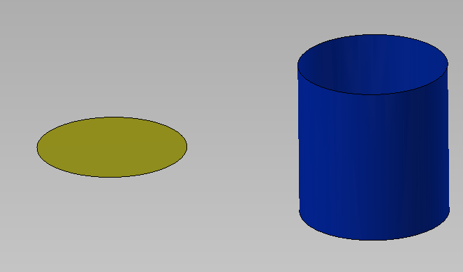

    Hi all,
    Wondering if someone could help me. The problem is simply reconciling stress analysis results with hand calculations and I suspect I'm simply setting up constraints incorrectly or something.
    A simple problem of an M6 bolt in single shear as in the image below. I am using the forumla in image to calculate the shear stress. The diameter (being an M6 bolt) is 6mm and hence radius is 3mm with a shear force of 1000 N being used. Using the forumla in the image below and the figures above, I calculate the shear stress in the bolt to be 35.4 MN/m^2 or 35.4 MPa if you prefer.
    My problem is that when I simulate this problem in Inventor 2013 stress analysis the results (for any kind of stress analysis; Von Mises, 1st and 3rd principal, all the planes etc...) are way way off what the hand calculation is, ranging from 160 MPa to around 800 MPa.
    Could somebody with the time to do so possibly talk me/post images of how to set this example up in Inventor correctly so that you get the same (or near enough) result.
    Many thanks,
    Sam

    Attach the ipt file here.
    Your formula gives the area of a circle where the image shows the force across the face area of two cylindrical faces.

    Hi JD,
    Still no luck really. I appreciate what you're saying in that in my forumla the force is acting over the cross section of a circle and doesn't take into account the thickness. I've used a different forumla: Shear stress = F/Dia.*(t1+t2) but still similarly disproportinate results. Besides all the text books I've used state the forumla I originally posted.

    The shear stress (4F/PI*D^2) is the formula for AVERAGE Shear stress on the cross section.  Your math is correct for this single shear problem (35 MPa).
    The stress JD is talking about is the Nominal BEARING stress which equals P/A.  Where A= D*t.  In your case, D=6 and t=3.  So the nominal bearing stress would be 1000/(6*3) or 55.6 MPa.
    I tried to setup the stress analysis on my own part also, but I couldnt get Inventor to give me the correct answer.  I suspect it is because FEA is looking at an infinitesimally small point that cause the stress to increase.
