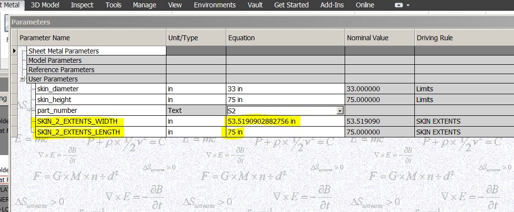

    I have an assembly containing several sheet metal parts. I have a spreadsheet that needs the length and width extents (stretchouts) for each of the sheet metal parts in the assembly.
    I created rules that that will update the custom iprops and the user parameter at the part level.
    My problem is this: I can not get the new length and width extents into the assembly custom iprops or user parameters without opening and and updating the part models individually.
    JPG 1: this is the ilogic that populates the user parameters and custom iproperties at the assembly, but it wont work.
    JPG 3+4: this is the ilogic at the part level that populates the user parameter length and width extents. This is the information I need to get into the assembly but I dont know how.
    JPG 1 (AT ASSEMBLY LEVEL)
    JPG3 (AT PART LEVEL)
    JPG4 (AT PART LEVEL)
    TO RECAP: I NEED SHEET METAL EXTENTS TO FILTER UP FROM THE PART LEVEL TO THE ASSEMBLY LEVEL.
    THANKS FOR ANY HELP
    DON

    So - you need an ilogic routine that opens each part file in an assembly, runs the 'create unfolded part'command, and then saves and closes each part...
    I don't have this routine, but I want it :smileywink: I hope that Curtis Waguespack is reading this!
    :smileytongue:
    I'll see what I can come up with, but it might take a few days for me to get back to it.
    In the mean time, this might be of interest:

    THANKS GUYS....FYI,,,,I CAN GET THE EXTENTS INFO AT THE PART LEVEL.....I JUST CANT SEEM TO PULL IT INTO THE ASSEMBLY..SNIFF...:catvery-happy:
