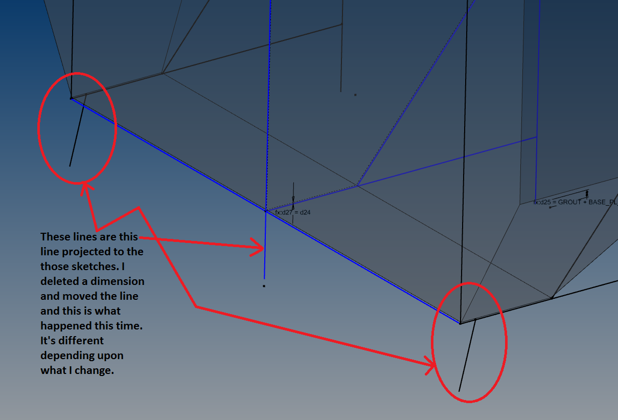

    Hello all,
    We just upgraded from 2011 to 2013 and we are having SERIOUS problems with our projected sketch geometry in parts not updating. We have only done this about 1.1 million times over the past four years and now every one of our skeleton models we touch is failing to update and causing a whole mess of delays.
    Please tell me there is a simple setting that we missed or something! I looked through the Application options for sketching and didn't see anything.
    Please help us! We are dying!:smileyfrustrated:

    Okay so here's one example but we are having this happen all over the place and we can't figure out what is causing it. This picture is an example of some skeleton geometry we are using with Frame Generator. If I make the change shown in the "before" sketch:
    I get incorrect results, like this "after" picture:
    It doesn't have to be this specific change, we are encountering this type of situation on a lot of different part files (new & migrated) and in a lot of different types of changes. Some simple dimensional changes, some more complex, but either way it's killing us. We paid for a parametric modeller so that things would automatically update with a parameter change and it's not happening. I can't figure out if it's a setting somewhere that's not right, user error, or what but I can say my workflow for these types of items hasn't changed in 4 years and it's only become a problem after the upgrade.

    Can't imagine what's going on at your place.  I can move the center leg in your file and the projected ones move as expected...  I haven't seen any issues in this area at all with 2013, either migrated or new files.  I know this isn't particularly helpful, but it appears to be something specific to your environment.

    I used your dataset and followed the steps as shown in the image but could't reproduce it on my two machines on R2013. I'm not sure what happens on your side. You may try to import the XML provided by Blair and let us know whether it fix your issue.

    Okay, so after playing around with this over the last couple of weeks we still have been able to isolate the issues but we have had some success in reducing the occurrences somehow. It doesn't appear to be happening as often as it was in the beginning of using 2013 but it still happens from time to time (I had it happen again yesterday).
    We used a completely new application options XML and, while that appeared promising in the beginning, it has not provided a compete solution at this point.
    We have noticed that is is somehow related to points not updating. This might sound weird but sometimes the lines move but the endpoints do not. Like the image I posted above, the bottom point moves, and the line moves, but the top point (and the top of the line) does not move and I end up with a skewed line when it should be straight.
    Yesterday I had a line move completely but it left one of its endpoints behind and my basic extrusion failed. It wasn't until I deleted the stray endpoints that it worked again. One of the points moved and the entire line moved/updated like it should, I just ended up with a point at the "old" endpoint that I had to delete for some reason.
    I wish I had more information but this is proving difficult to isolate and reproduce consistently. Any more help that can be offered would be helpful.
